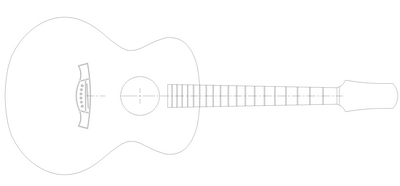

ahhh....then I assume MJ stands for Medium Jumbo?..sounds perfect!
PostPosted: Wed Oct 24, 2007 8:11 am
Yep Medium Jumbo
16 1/4 lb
12 1/16 ub
9 3/8 waist
4 3/4 major depth
4 1/16 minor depth
20" long
Here is the shape
